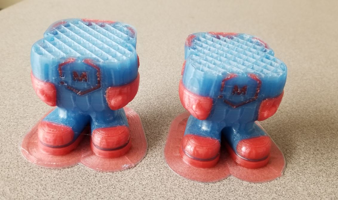

First and second print fail at the same height.
Third try fail higher. the one on the right side.

Ok, guys think I found the source of the problem. The connector that I made for the T0 was not tight so it was shaking when printing which creates a short inside the connector. So after about 6 hours of printing everything looks good.
Finish Print
I need to calibrate my extruders and Tune cura.
Cura
Polymaker 2.85mm PolyLite PLA Filament Translucent
.6 Nozzle
.3 Layer Height
10% Infill.
This was print at 150% scale.
