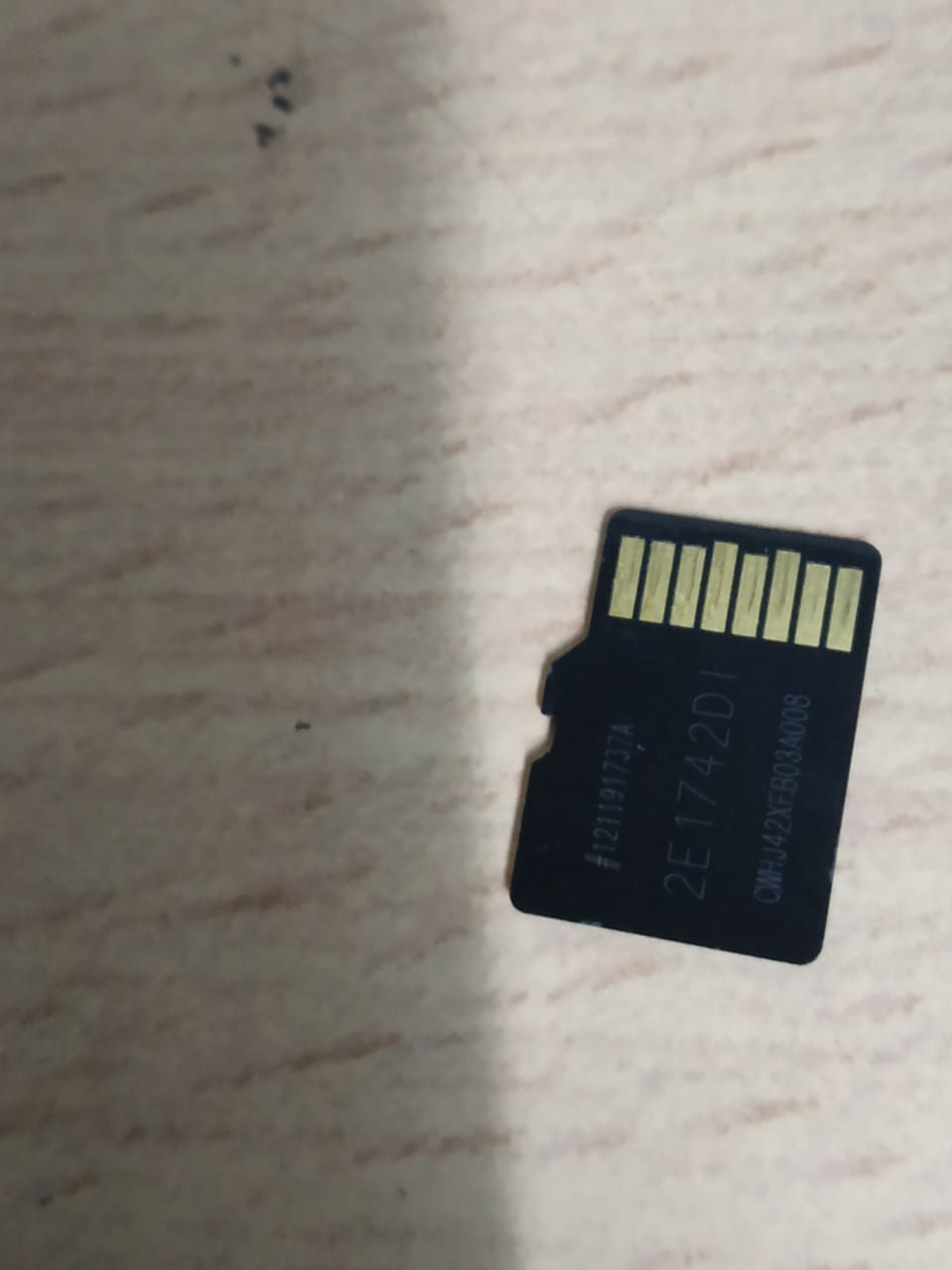

hi guys, i have a duet wifi board today i rewired to a cleaner setup after that, i noticed something very strange. wifi chip stop working, apart from that whenever i connect my duet with min usb the area near the memory card gets super hot within seconds. what could be the issue?( i disconnected immediately as i sensed heat), also the fuse is totally intact.

The sd card is damaged i have checked!
Blown SD card and overheating WiFi module are the classic signs of having had an over voltage on the +3.3V rail. The usual causes are a short between +3.3V and either VIN or +5V, or a short between VIN and +5V (which often blows the 3.3V regulator too).
