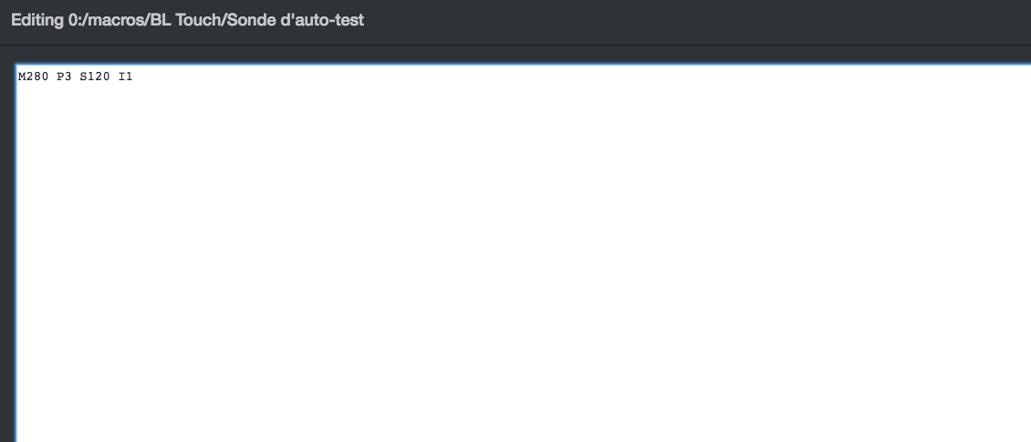

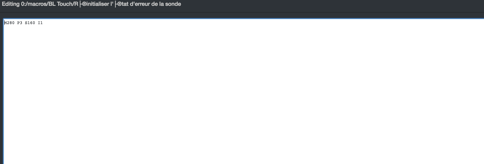

Since the update of my duet wifi card, I have 2 macro commands for the BL TOUCH which does not work anymore.
Self test probe and error condition of the probe.
Do the code change?
Thank you for your answers. -

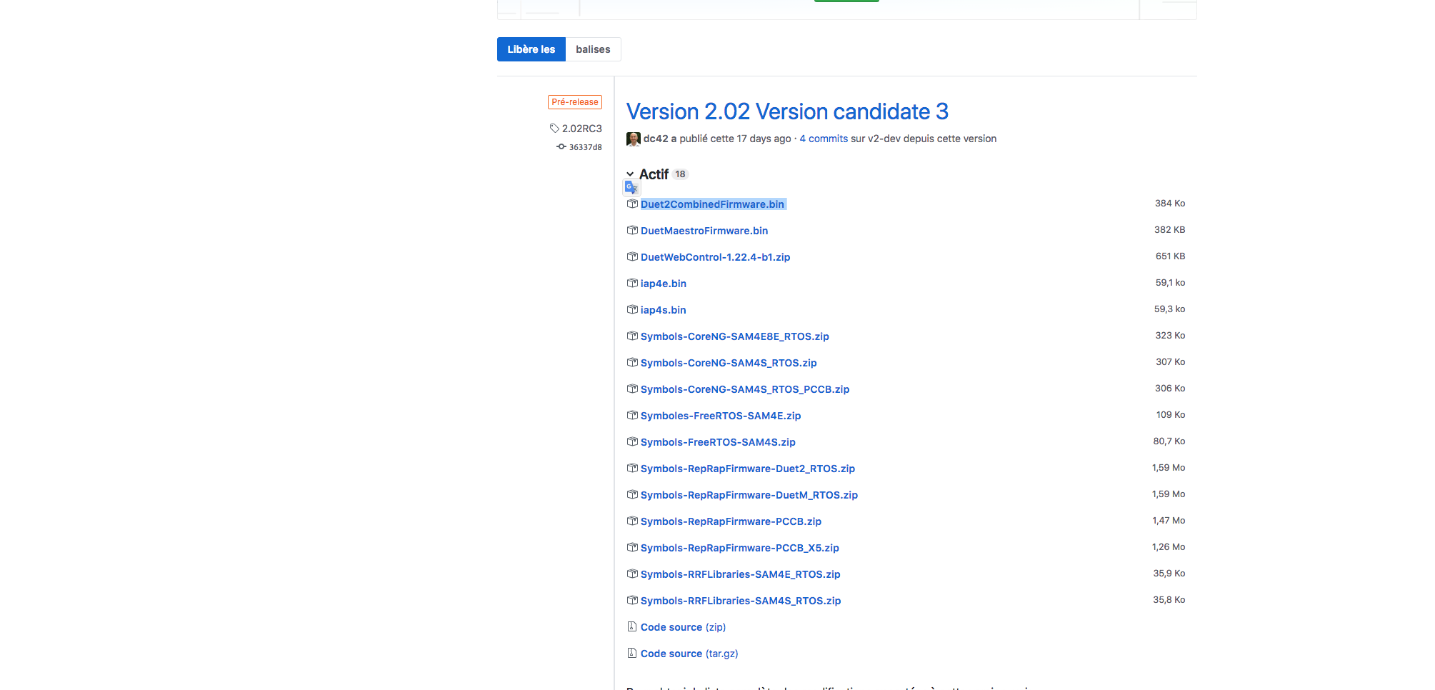

Or can we find the corresponding .bin file because I have the same file but it is in .ZIP
thank you -
If you had the Duet replaced but kept the old SD card, maybe you just need to update DWC.
Ok DAVID,
But where is the .bin file.
I only find the file in .ZIP, I have to change the extention of the file?

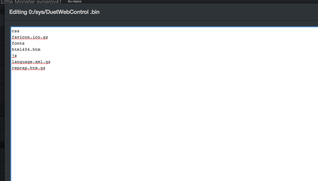

I put my card with this file
If your Duet firmware is 1.19 or later then there is no longer a DuetWebControl.bin file. Instead the DWC files live in the /www folder of the SD card. See https://duet3d.dozuki.com/Wiki/Firmware_Overview#Section_SD_card_structure.
Good evening DAVID,
Yes I delete the folder "WWW" from my SD card, then I submitted the new version but the problem is still present.I try to run the 2 commands via the console and no problem.
Only launching it with macros is a problem.
Thank you for your help -
That's the wrong folder. Those files and folders must be in folder /www. I think you have some old DWC files in /www instead.
