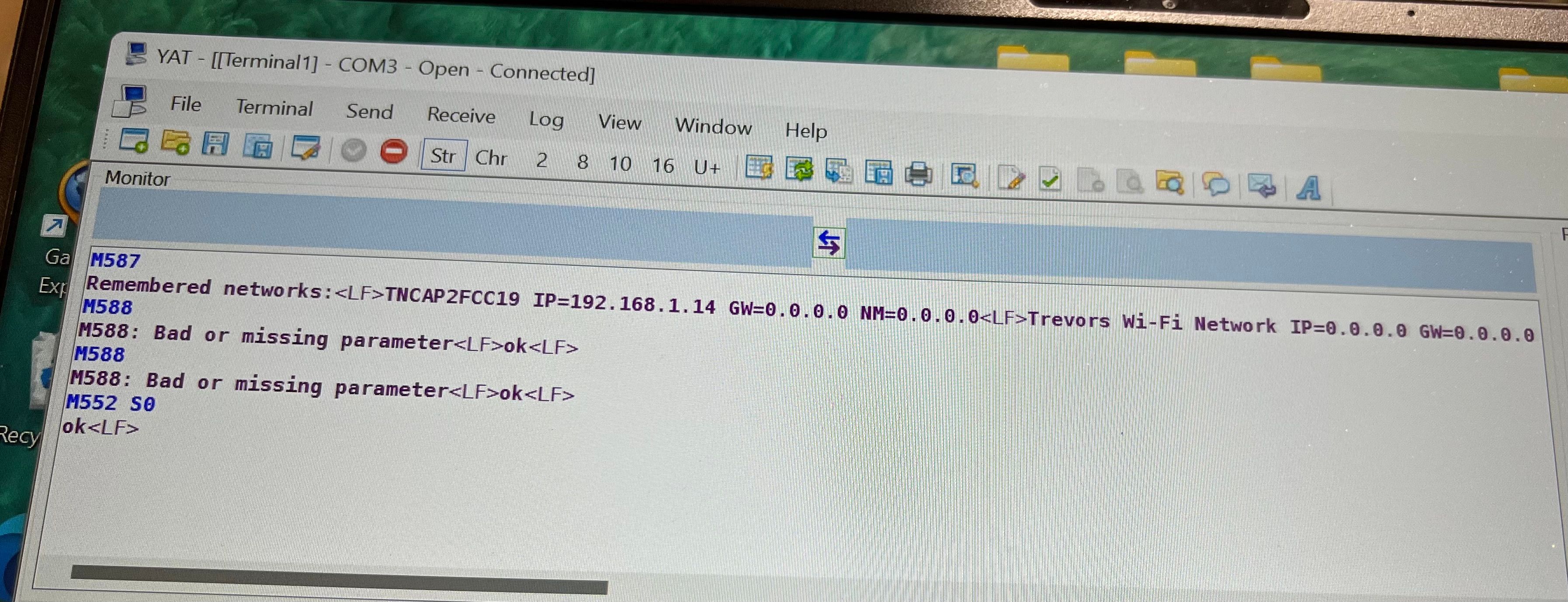

@droftarts Thanks Ian for your help, you have probably worked out I am no expert at this. When I put in M587 as suggested I get response as photo attached. I tried M588 to remove remembered network which doesn’t look right. .14 (there are usually 3 numbers.) Removing it doesn’t work, I am sure I am missing something. When I try setting up new ip using M587 I get OK response but never get the new ip address
First, you'll need to change the line endings in YAT so we can see multiple lines.
Second, the command to forget networks is
M588 S"*"
Also, sending M552 by itself will give some information as well.
@phaedrux will have a look and get back to you
@phaedrux have managed to get new ip 192.168.1.156. And got machine working, it seems to be retaining ip so far. The files just sent were taken after achieving 192.168.1.156 ip
