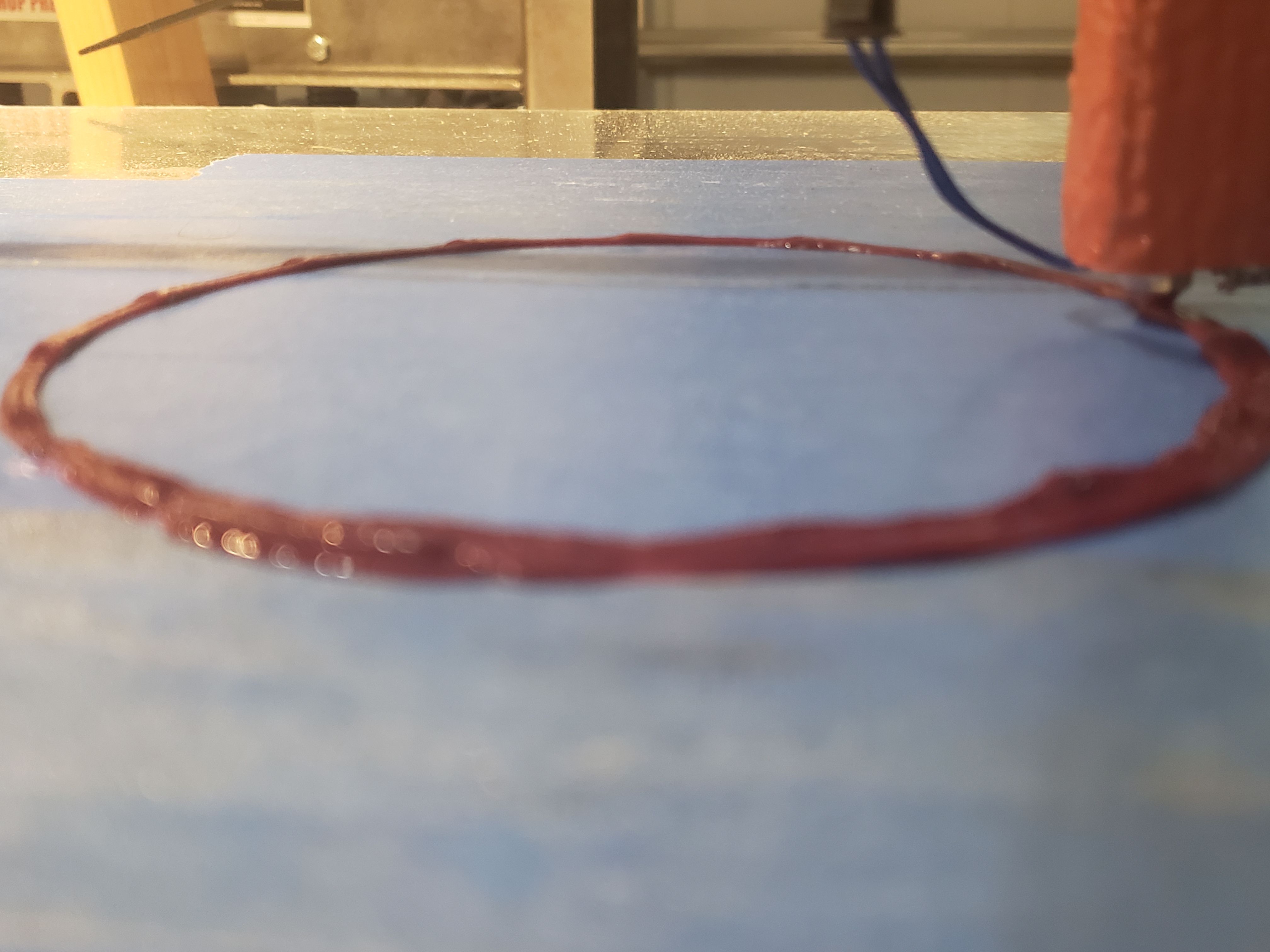

2.85mm "bargain basement" PLA, 1650 mm/min at 230 temperature. Notice the "pulsed" affect the filament has on the far side of this print? Is that the heater switching on/off for PID? I updated the firmware and I'll run Auto Tune a few more times. Takes FOREVER to cool down with that sock on there... but that's a good thing, right?
Is that a direct drive extruder? If so a geared extruder would help get some torque and smoothness to improve the flow.
@Phaedrux Yes it's direct, I'll look into gear extruders
