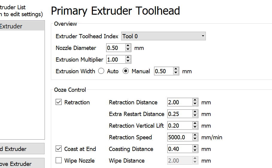

0.25mm extra restart seems like a lot to me. That could explain the seeming over extrusion after a retract.
Also, coasting/wipe and PA don't always play well together. I suggest turning coast and wipe off and experimenting with PA by itself.

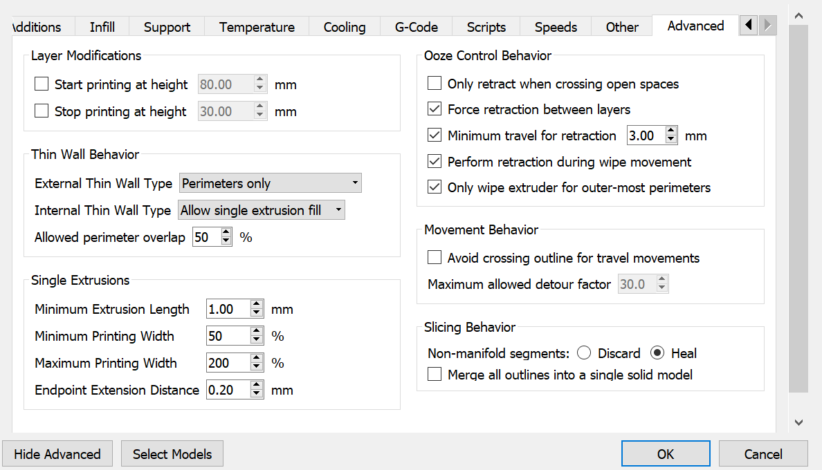

Try turning off the Zhop (retraction vertical lift). I don´t why, but this did the same issues for me as you have. Also, try disabling "force retraction between layers" and enable "only retract when crossing open spaces"
