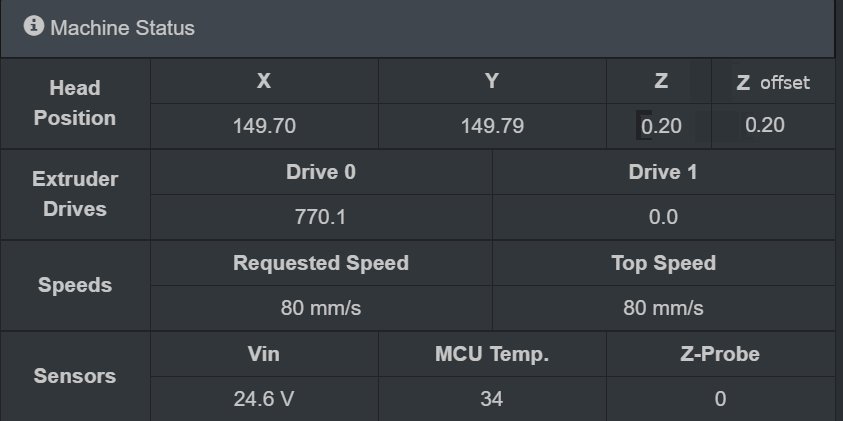

@dc42 I was having a little difficulty understanding what the issue is here but now I think I do. If I understand correctly and cut through all the personal stuff, in simple terms, it looks more like a DWC issue than a firmware issue and I'd say it's nothing to do with the implementation of baby-stepping as such.
So if one homes the printer, then go into the job status section of DWC and hit baby stepping a number of times, the bed will move (on a moving bed system) but the machine status section does not report the new position of Z. In my case, after homing, the bed is at 10mm. So hitting baby stepping say 10 times will give an offset of 0.5mm, the bed itself does indeed move 0.5mm but the displayed head position for Z does not change. In my case, it still shows Z being at 10mm. If one then re-homes the printer, with that 0.5mm offset still applied, then after homing the machine status section shows the Z height to be 10.5 mm which is the correct position.
I think the only change that's needed is that DWC should show the Z position with whatever offset is applied as soon as that offset is applied (i.e. whenever the baby stepping button is hit). I think the physical position is correct - it's just not always being displayed correctly.

There are essentially two positions: the user position and the machine position. The user position is what the user asked for in GCode. The machine position is what the firmware moves the head reference point to after applying the tool offset, workplace coordinate offset, bed compensation, axis skew compensation, and babystepping.
For most purposes, it's the user position that the user is interested in. If a user commands the head to X10 Y20 Z5 then it would appear odd if the reported position is something different. So it's the user position that DWC displays.
However, RRF provides both the user position and the machine position to DWC. So it would be possible to change DWC to show the machine position instead, or to show both positions. I expect this will be an option in DWC2 in future. If you want to patch DWC to display machine position instead of user position, search the .js file for references to field ".xyz" of the status response and replace them by ".machine".
@dc42 said in Suggestion for change to implementation of baby-steps:
.........................For most purposes, it's the user position that the user is interested in. If a user commands the head to X10 Y20 Z5 then it would appear odd if the reported position is something different. So it's the user position that DWC displays....................
Personally, I don't give a damn as I don't have a need to use baby stepping. But, I think this is what the OP is complaining about. That is to say, if the user presses the baby stepping buttons to essentially command the head to move from say Z5 to Z4.5 then DWC still displays the position as being Z5.0 even though it is actually 4.5. I guess it depends on whether baby stepping is defined as a move command.
So we have the situation where DWC shows the Z height without the offset (5.0) and also displays the offset (0.5). But then if the printer is homed still with this 0.5 offset applied, then after homing DWC will show the Z position as being 5.5 (i.e the Z position plus the offset) and also still shows the offset as being 0.5.
So there is an inconsistency in how DWC displays the Z height depending on whether the printer is homed before or after baby stepping is applied. Maybe that's how it is but
I can see how this would get confusing. i.e. prior to homing DWC displays the Z position without the offset, but then if the printer is re-homed, it shows the Z position including the offset. The offset value itself does not change when homing happens.So how can an end user know where the print head is in relation to the bed if the displayed value changes depending on whether the printer was homed prior or after the baby stepping buttons were pressed?
As I said, personally I don't give a damn as I don't use baby stepping so I'll leave any further debate to others.
@deckingman said in Suggestion for change to implementation of baby-steps:
You make it sounds as though the displayed value for a given actual position depends on whether you home before or after babystepping; but that's not the case. Suppose your Z probe or Z endstop triggers at 5mm. If you home and then apply 1mm babystepping, the head will initially be at 5mm but after you apply the babystepping it will have been raised to 6mm. If you then home Z again, the head will be at 5mm above the bed (not 6mm) but 4mm will be displayed.
All this ignores the fact that if you have a tool offset applied, or bed compensation applied, the height will be further adjusted.
Perhaps one option would be for DWC to display the baby stepping offset alongside the Z coordinate.

For info, I just tried this out on my machine. It seems to work as you say with one exception. When I input M290 S5, I only get an offset of 1mm. I'm guessing that there is a 1mm limit on baby stepping? If not, then something is amiss.
Anyway, here is what I got......
G28; home all - after which....
Measured nozzle height =10.00mm (as expected with the commands I use)
DWC shows Z= 10.00
Baby stepping offset shows 0 mm.G1 Z0 - after which......
Measured nozzle height =0mm
DWC shows Z= 0.00
Baby stepping offset shows 0 mm.M290 S5 - after which....
Measured nozzle height =1.0mm
DWC shows Z= 0.00
Baby stepping offset shows 1 mm.G28 Z - after which
Measured nozzle height =10.0mm
DWC shows Z= 9.00
Baby stepping offset shows 1 mm.G1 Z0 - after which
DWC shows Z= 0.00
Baby stepping offset shows 1 mm.M290 R0 S0 - after which
Measured nozzle height =0.0mm
DWC shows Z= 0.00
Baby stepping offset shows 0 mm.HTH
Edit. This is just for your info - I don't use baby stepping myself but I had a few minutes to spare so ran those tests.
