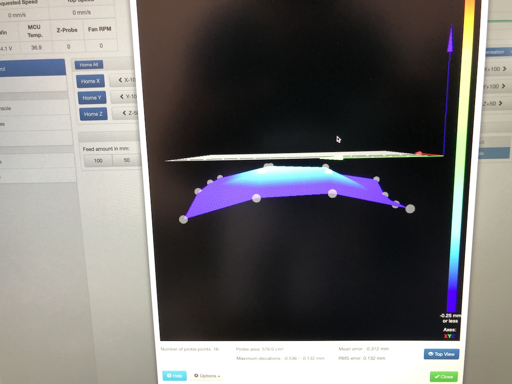

Is there a way to compensate for the bending of the rods while probing at the center of the bed (Rod length is 480mm)? This is with very high sensitivity and a fast probing speed (to ensure it picks up the point on the piezo disk)
EDIT: Am positive the build plate is flat and does not have a belly in it. Difference from outer edge to center in Z is 0.15mm after probing (from mesh).
That's exactly the sort of thing that G29 is for. Although it's usually called bed compensation, it's frequently used to compensate for sag in the gantry too. The firmware doesn't know whether the bed is bulging or the gantry sagging, the effect and the compensation needed are the same. But if you are sure the bed is flat and the gantry is sagging, don't use bed compensation taper!

I think what you mean is that the force between the nozzle and the bed while probing causes the rods supporting the nozzle and/or the bed to bend, and that bending delays triggering. But surely that would cause the height map to have a dip in it, not a bulge?
the force at which the piezo is triggered is very small. surely not enough to bend your rods .4mm. And still it would cause a dip..have you tried with a lower probe speed?
Also the bulge is larger in the center than it is on the sides. Is this corexy? Then the center is the accumulation of sag in x and y axis. Whilst on the edges in the middle it is only the sag of 1 axis -
That’s exactly what I was trying to say. Thanks.
I guess you are right as it would show up as a dip wouldn’t it.. I’ll have to do a little more investigating

Also the bulge is larger in the center than it is on the sides. Is this corexy? Then the center is the accumulation of sag in x and y axis. Whilst on the edges in the middle it is onlyIt is a CoreXY with >400mm 8mm rods so it may be sag?
I did try a lower probing speed but that just required more force (and bending of the rods) to trigger the piezo.
@chanders i think it is sag..I have a corexy hevo and had the same problem..used X/Y axis mount where the x-rod is hold at 2 places on each side which makes it a bit stiffer...
Do you have a direct extruder, i.e. more weight than a bowden? -

Do you have a direct extruder, i.e. more weight than a bowden?My CoreXY is also a HEVO. Its a bowden setup so not so much weight on the rods, even though the cables may be adding some weight to the gantry.
