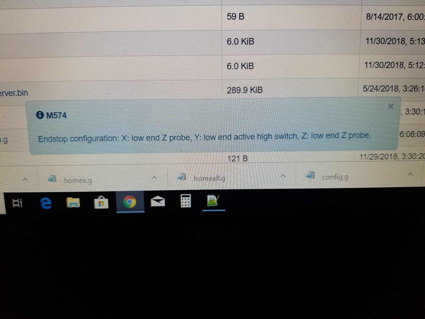

Hi, Running 2.0 version of the firmware. I have a Railcore II corexy that I am building.
Going through the steps checking the end stops. X and Y end stops are setup as NC. The x and Y end stop LEDs on the DuetWifi are both Red. DWC shows Y end stop as no, I press the Y end stop switch and the LED turns off and the DWC shows Y switching no to yes. DWC shows the X end stop as no, I then press the X end stop switch and the X LED turns off but DWC still shows the X end stop as Yes. M574 gives me this response: -
@quadcells It's because you have configured X to use the Z probe - M574 shows "X:low end Z probe" . If you are using a switch, it should be configured the same way as the Y axis.
Edit. So you need something like M574 X1 S1. I suspect you have M574 X1 S2. https://duet3d.dozuki.com/Wiki/GCode#Section_M574_Set_endstop_configuration
@deckingman this is my M574 line: M574 X1 Y1 Z0 S1
Ok I also have this line right below that one:
M574 X1 Z1 S2 -
@quadcells There you go then.
BTW, if you use the probe for homing Z, then you need that second line with the S2 (but without the X1 obviously). So M574 X1 Y1 Z0 S1 followed by M574 Z1 S2.
@deckingman Yes. Thanks
