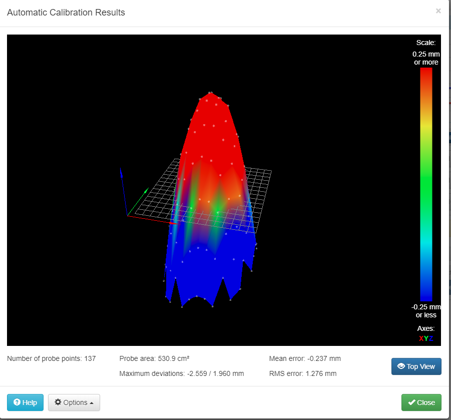

The TLM has a glas plate as printing bed. I have ran the mesh grid compensation and i got results which i dont undestand how it is possible or what could be wrong.
i am really sure, that is just an error calls EIFOK (error in front of keyboard).
i thought it should looks more flat and not like the mount everest.
What i have done wrong?If i would run my printer by using the mesh grid compensation, he would be crashing with the bed surface
ill upload my config.g and my bed.g. I hope someone can help.
It seems to me, that you hava a problem with your basic delta configuration. I made something very similar on my first try, I had the "Delta radius" wrong. Please check the basic delta config: rod length, Delta radius, steps/mm.
My delta radius is 170 mm and the printable radius is 160 mm

I think your delta radius is wrong. I do not have a machine like that, but at a forum thread I red that R155.83 is used by the poster and this miscalibration could easily be responsible for the error you experience.
The delta radius is the horizontal component of the delta rod from bearing center to bearing center when the hotend is homed.You should also setup your delta auto calibration using 10 outer and 6 halfway points, then after the calibration send M500 from the gcode console. This creates a config override file containing very precise calibration data including M665 with all it's parameters. If you have an M501 at the end of your config.g then it loads this config override file at startup.

Thank you! You saved my Printer from getting stowed in the basement!
I always thought that the delta radius means the radius of the printing bed...

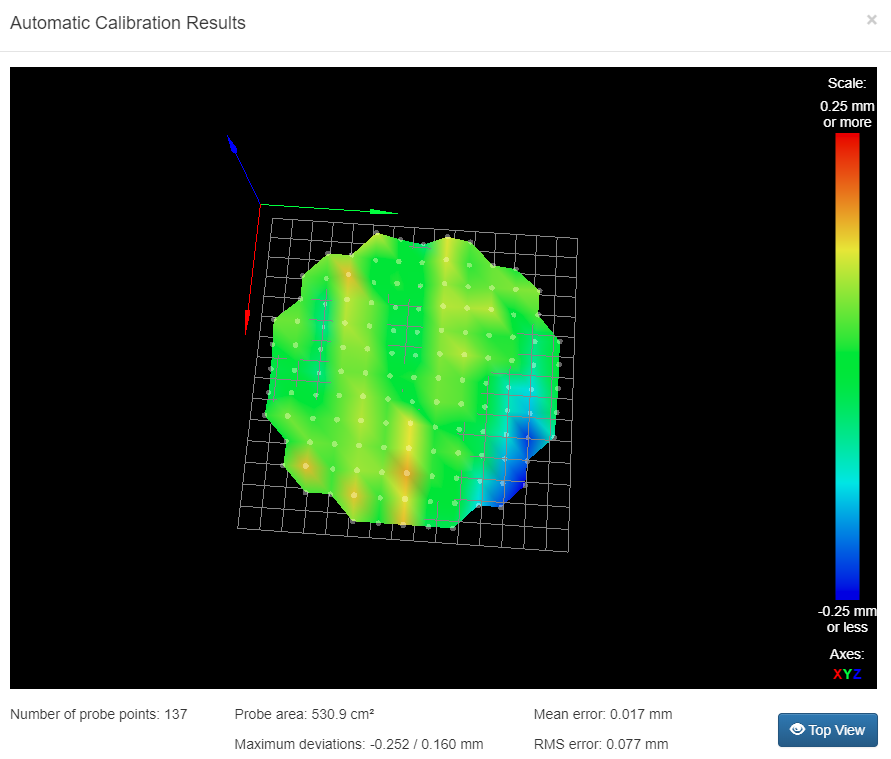

With M665 R156.7 L400 B160 H520.5 i got this results
Is there any instruction how to measure the delta radius correctly?
My glass plate is in real slightly tilted.

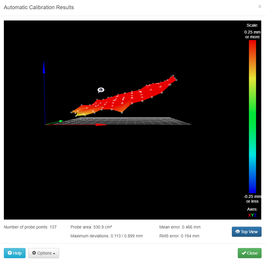

You need to first calibrate your Z probe, see https://duet3d.dozuki.com/Wiki/Test_and_calibrate_the_Z_probe, and then run delta calibration, see https://duet3d.dozuki.com/Wiki/Calibrating_a_delta_printer#Section_Setting_up_your_initial_delta_parameters and the following section. If you use 8-factor compensation then the beld tilt will also be taken care of.
@dc42 said in Tevo Little Monster - mesh grid results:
Hello dc42,
thanks for your reply.
i have now determine the Z offset (0.26 mm) and placed the value in config.g
the configuration tool and Escher 3D only showing 7-factor. have i something overlooked?
You can select 6- or 7-factor, then change S6 or S7 on the final G30 command to S8.

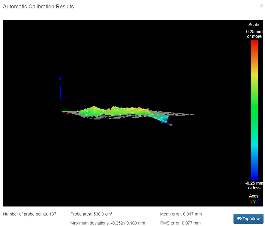

After auto calibration i have ran the mesh grid compensation and it looks much better then before

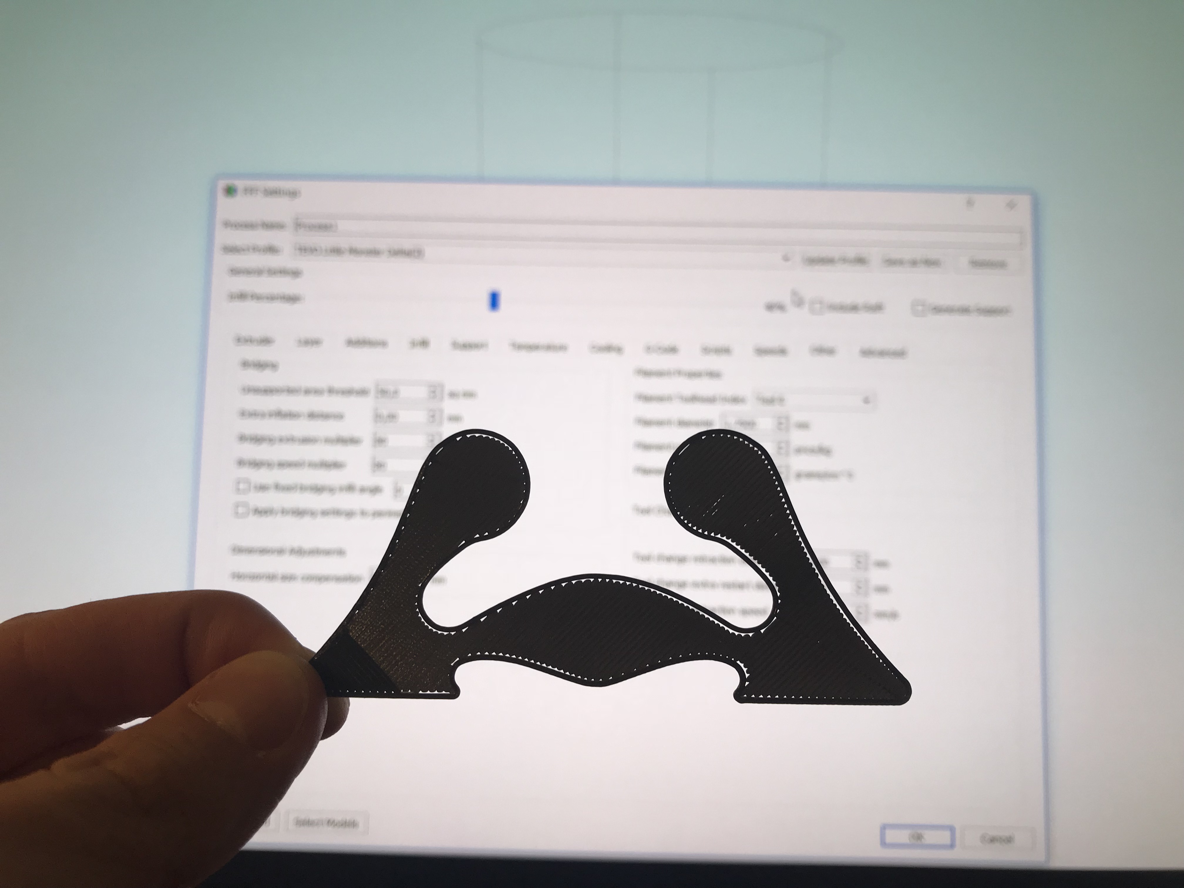

This is how the first layer is looks like
What i am doing wrong?
Check the hotend height with a sheet of paper when z height is 0.
Either you have the z height wrong caused by faulty trigger height, or you are underextruding so the extruder steps/mm should be checked too. -
