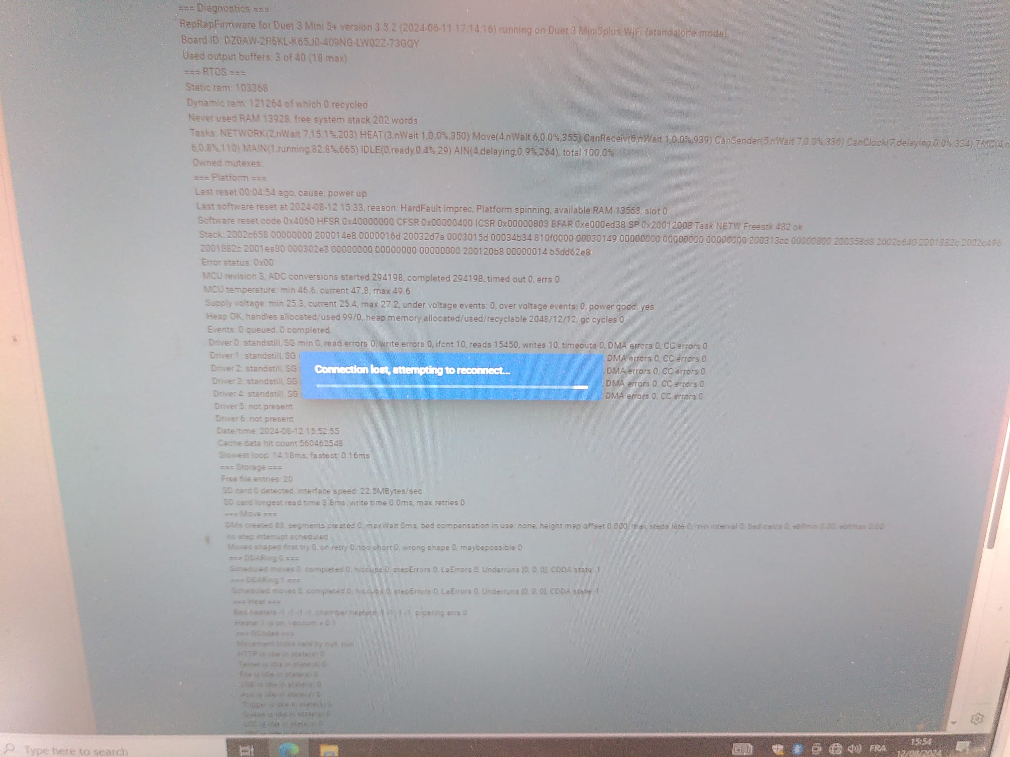

      Dear all,
      I have been getting HardFaults while printing on firmware 3.5.2, and previously on (if I remember correctly 3.4.6) on a Duet3D Mini 5+ WiFi while printing ASA.
      Also I have the idea that the wifi is taking longer to connect than it used to. The Duet is set-up as an AP. My laptop used to connect within 10-30 seconds. Now it takes minutes and sometimes I even have to reboot the Duet.
      Is there any work being done on firmware 3.6 about these HardFaults? Or are there other causes that have been narrowed done? If I read the other topics one users has not had any issues since 3.5.1 but for me it's stil happening.
      I have 2 12V-batteries hooked up in parrallel to a Chinese PSU. Voltage is stable.
      chrishammundefined dc42undefined 2 Replies Last reply Reply Quote 0

        chrishamm administrators @fromwastetowind
        @fromwastetowind Some filaments tend to build up electrostatic charge so it is important to have all the metal parts of your printer grounded. Is that the case? If yes and the problem persists, please share the output of M122 via copy&paste here after the next crash and I'll take a look.
        Duet software engineer
          dc42 administrators @fromwastetowind
          @fromwastetowind as it's a Duet 3 Mini WiFi it may be an instance of https://github.com/Duet3D/RepRapFirmware/issues/935.

            fromwastetowind @dc42
            Thanks for the replies so far.
            The printer is not grounded as I never had any issues with it (on my Duet3D Mini 5+ Ethernet, with other mechanics and other PSU). I'll try connecting DC- with mains as dc42 suggests here: https://forum.duet3d.com/post/48107 This method raises the question if the printer frame, hotend, etc. should be on the same connection, since the mains ground should never be open to touch by people.
            I could not find anything on the official Duet3D howto's about grounding, maybe it should be good that the information is there?
            fromwastetowindundefined 1 Reply Last reply Reply Quote 0

              I grounded the PSU (connected negative DC to mains ground, but yet I received another Hardfault imprec.
              Is there anything being done to resolve this issue?
              droftartsundefined 2 Replies Last reply Reply Quote 0

                @fromwastetowind I think @rechrtb and @dc42 have been tracking down what causes this crash, so will hopefully have a fix soon.

                    droftarts administrators @fromwastetowind
                    @fromwastetowind See @dc42's reply to your original post for links to similar threads. I understand that the fix is still being developed, is being worked on internally (so not covered in the forum), and is beyond my comprehension to describe!
                    Please could you post the output from M122, it may be useful to see. Ideally, copy and paste the text from DWC into your reply, rather than taking a picture of your screen.
                      @fromwastetowind said in HardFault Imprec, HardFault invState,.. Printer crashes!:
                      Also note that this is not what is meant by "grounding your machine". We mean connecting the metal parts of your machine to a common grounding point. This includes the hot end and extruder metal parts, and is what @chrishamm was referring to. Running filament through the extruder can cause a static electricity build up, which can arc out through the stepper motor wiring, or through the wiring to the hot end (hot end heater or temperature sensor). Any of these may cause enough of an electrical discharge to corrupt memory on the MCU (leading to a crash) or even damage or destroy the electronic components on the controller board.
                      We also recommended that the stepper motor casings be grounded, especially in belt-driven printers. Motion of the belts also causes static charge to build up, which eventually arcs over to the windings. If the motors are screwed to a metal frame, grounding the frame is usually sufficient.
                      It is not recommended to connect the output ground (ie negative) of any power supply to mains neutral. It can lead to electrocutions. It is also not recommended to connect the negative power output to earth ground, as it can trip the RCD or harm the power supply. Connecting the frame to PSU negative can cause electrocution in case of a power supply internal fault.
                      Ideally, run the earthing wire from the power outlet (not the earth terminal of the PSU) to a common grounding point (eg a bolt on the frame), and then run that on to the earth on the PSU. Then run grounding wires from all components that require grounding to this common grounding point.

                        fromwastetowind @droftarts
                        @droftarts
                        Thanks @droftarts. I just tried grounding like you propose but the printer still halts randomly. These are the M122 reports from the last 2 halts:
                        M122
                        RepRapFirmware for Duet 3 Mini 5+ version 3.5.2 (2024-06-11 17:14:16) running on Duet 3 Mini5plus WiFi (standalone mode)

                        • dc42undefined dc42 referenced this topic
                          All, please see https://forum.duet3d.com/topic/36689/random-hard-fault-resets-on-duet-3-mini-wifi and provide any additional reports there. I am locking this thread.
                          • dc42undefined dc42 locked this topic
