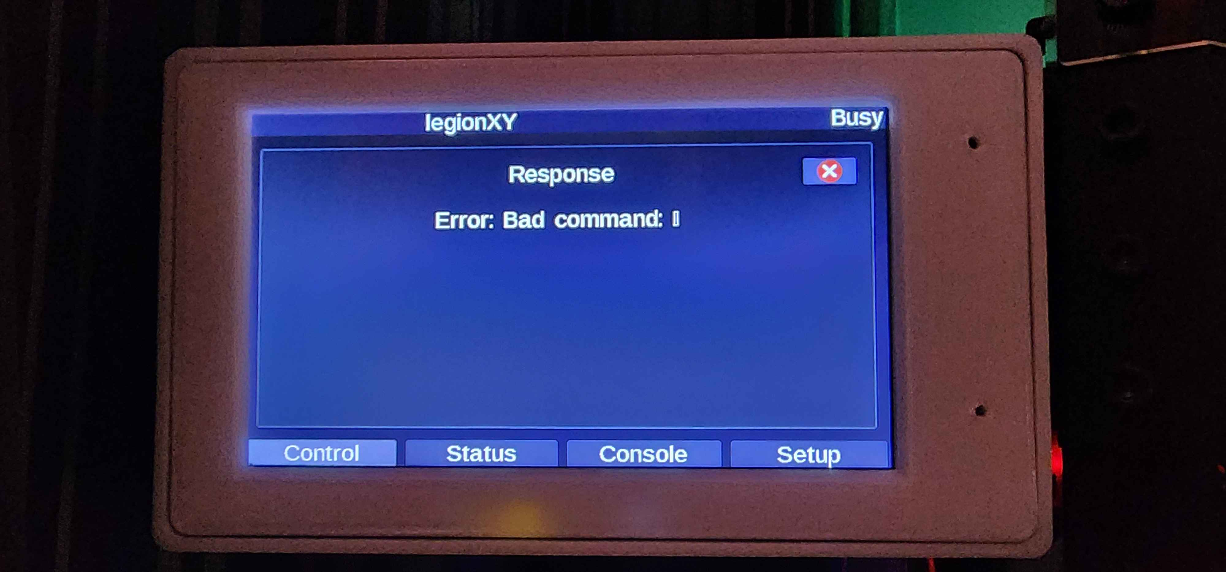

While I was troubleshooting this issue, I copied my configuration to an SD card to test if I could reproduce the error in standalone mode following the instructions here.
Upon starting a test print in standalone mode, the DWC console contained several errors while executing start.g that were not present when the same configuration and job gcode was run in SBC mode.
There is also a corresponding error that appears on the PanelDue.
It's difficult to know which commands are giving an error, but from the timestamps the errors seem to coincide with meta gcode commands in homez.g, bed.g, and mesh.g. these errors are unique to standalone mode. I don't get the same behavior in SBC mode.

And aside from the console errors, the print completed without issue.

Can you view the files in a text editor that shows hidden characters?
Or upload the files directly so that we can check them? -
I notice a lot of tabs in the other called macros, so I'd go through all your files and give it the same treatment with NP++
And for a sanity check you can create a basic config using the config tool and see if you get the same issues or not.
@Phaedrux It looks like the error was in one of the nested macros I use to lower motor current during homing as after running the blank operations I mentioned above on the files in the
/sys
folder, the error no longer appears. I guess SBC-mode was acting as an additional filter and caught it which was why I never encountered the errors before.Thanks for the help!
