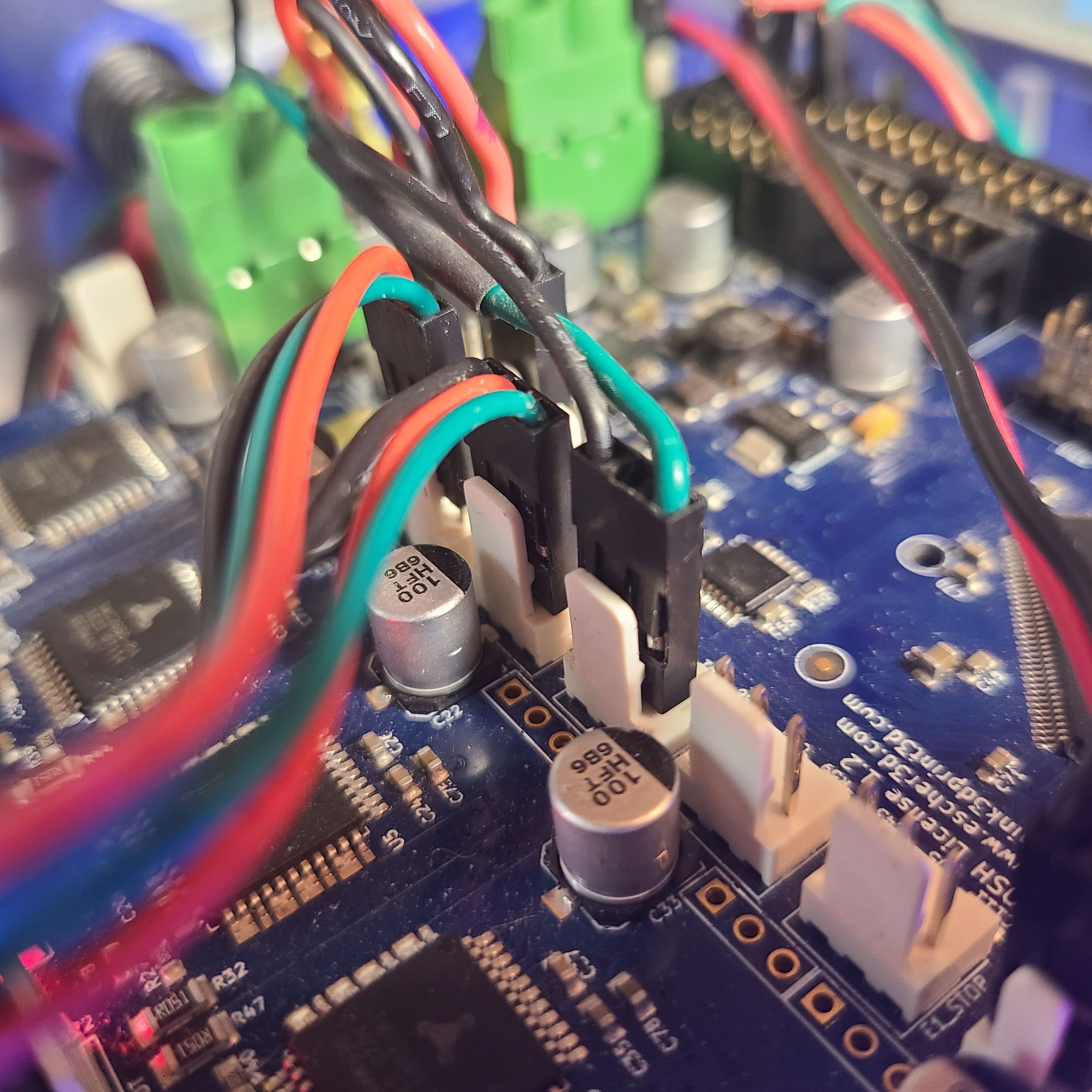

Converting From X Endstop On PCB to Simple Micro Switch
For the sake of a sanity check and you take a photo of the switch and the board endstop port?
Is there perhaps a solder bridge or stray wire making contact?
I would check the wires for continuity.
@gbusy24 Pushing the switch by hand, it goes to untriggered.
@phaedrux Okay.
@gbusy24
Did you also use the two outer pins on the microswitch ?
Are there symbols for the pin assignment on the microswitch housing ?A photo of the microswitch pins might be helpful.

In my opinion you don't need the following line.
M574 X1 Y2 S1 ; X home to min. Y home to max. Normally Closed limit switches.
To test it, put a ; in front of it and restart the printer and test whether it works.Google Translate

@günter-jibben
@günter-jibben I just tried that and it didn't help.
@gbusy24
Too bad it didn't work with the ; before the command line.
But I still think this command line is unnecessary, but the moderator can tell you more about it, he is more familiar with it because it is his daily job and he knows the various configurations.
I don't have the line and I couldn't find it anywhere in the documentation.
mine looks like this...; Endstops M574 X1 P"!xstop" ; configure unsupported switch-type endstop for low end on X via pin xstop M574 Y1 S1 P"ystop" ; configure switch-type (e.g. microswitch) endstop for low end on Y via pin ystop M574 Z1 P"!zstop+!e0stop" ; configure unsupported switch-type endstop for low end on Z via pin null
On the Z-axis (2 endstops) and on the Y-axis I have self-made endstops that work with a HAL-Sensor and a magnet that I can adjust.
I still have the original endstop microswitch on the Y-axis, but with an LED and three cables.You should use the two outer pins on the microswitch, i.e. C and NC
C is the input and NC and NO are the outputs.
NO = Normally Open
NC = Normally closedGoogle Translate
