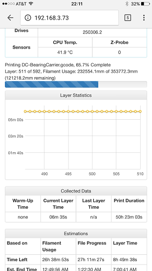

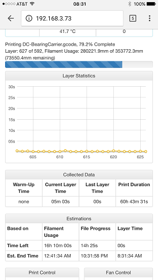

The printing status area of the UI has some peculiarities for me.
The example screen shots are from the same print. The second is taken about 8-10 hours after the first.
These items seem to be bugs:
1. Total layers shows less than the real total. In the example shots, it shows "Layer: 511 of 592" and then later it shows "Layer: 627 of 592". 592 is not the correct number of layers.
2. Last layer times show "n/a" and "00s", neither of which are correct.
3. Layer Statistics Graph on the later screen shot shows close to 0 for layer times, but this clearly is not correct.
These items are "It would be nice if....":
4. At some point it would be nice to show Filament Usage data in cm, then meters. When a print needs multiple 1KG reels, it's way to many digits when displayed in mm.
5. Est End Time it would be nice to include a date when the end time is not today. As you can see, this is a 2.5 Day print. I'm old and get easily confused

Thanks for the feedback, I have moved this to the DWC wishlist because the majority of these are feature requests. I hope cHristian will have a chance ot have a look at these requests as soon and comment further.
The one bug, where DWC is showing the wrong total number of layers, I wonder if there is something in the header of the Gcode, output by the slicer, with the total layer numbers?

The reported layer height (592) * 0.4 = 9.3" which is about the actual height of this print. The printed layers on this print went to about 750 before it finished. The print is not that tall.
I think that every time there is a Z move, DWC counts it as a layer completed. Not sure on that but I think that's what happens. If ever you try spiral vase mode, you'll see what I mean. So it could well be that, if the supports are at different layer heights to the main object, then that would screw up the number of layers completed (vs the number of layers expected).

I was getting the wrong layer count, apparently because (IIRC) I had something like
G1 X0 Y0 Z285 E-5 F6000 ; Retract filament as soon as possible and home
In my Ending Script, and the software somewhere was interpreting the Z285 as the height of the last layer.
I changed the script to [c]G1 X0 Y0 Z285 E-5 F6000 ; E Retract filament as soon as possible and home[/c] (I think it had something to do with the "Retract" in the comment!), and now I get the correct number of layers.
I could have the details wrong, but there's a thread on it somewhere in this forum.
To add a data point to this thread, I'm a fairly new Duet user. I've seen layer issues myself several times. Right now, I'm about halfway through the first layer of a pretty large bed area print, and DWC is reporting I'm on layer 9 of 86. It should be layer 1 of 90.
Please submit any GCode files that give rise to an incorrect indication of the number of layers.
