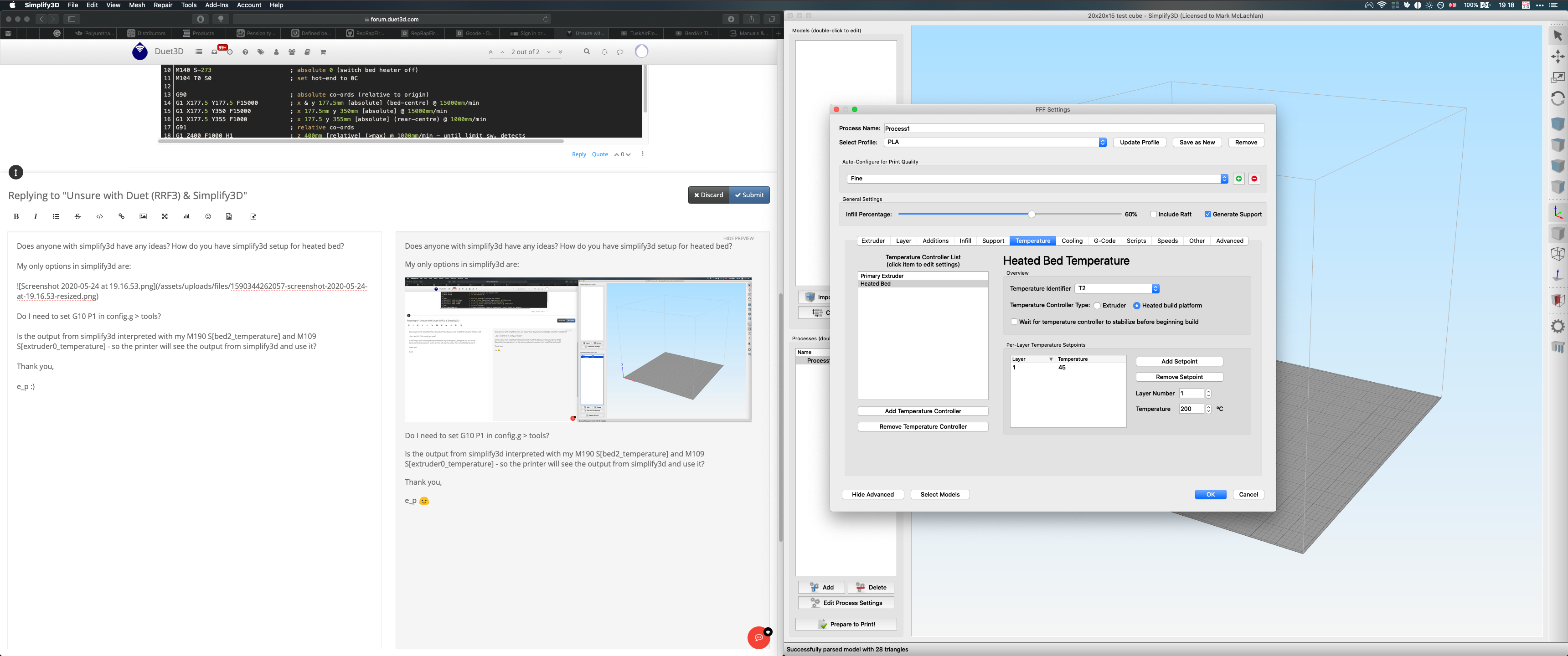

Does anyone with simplify3d have any ideas? How do you have simplify3d setup for heated bed?
My only options in simplify3d are:
Do I need to set G10 P1 in config.g > tools?
Is the output from simplify3d interpreted with my M190 S[bed2_temperature] and M109 S[extruder0_temperature] - so the printer will see the output from simplify3d and use it?

I tried running a print of a test cube but I'm getting heater faults:
Warning: Tool 0 was not driven because its heater temperatures were not high enough or it has a heater fault
I have tried changing my starting script but I'm unsure what I should put in M190 and M109 so it correlates with simplify3d.
I have:
T0 ; select tool 0 (hot-end) M190 S[bed0_temperature] ; set bed temperature & wait M109 S[extruder0_temperature] ; set hot-end temp ; change M109 to M104 T0 S[extruder0_temperature]? M116 H1 S2 ; wait: hot-end = S[extruder0_temperature] +/- 2C G1 E10 F500 ; extrude 10mm @ 500mm/min (prime) G1 X5 F10000 ; x 5mm y 0mm [absolute] @ 10000mm/min (wipe start position: x 5 y 0) G1 Z0.10 F1000 ; z 0.10mm [absolute] @ 1000mm/min (bed up to begin wipe) G1 X177.5 E5 F15000 ; x 177.5mm [absolute] & extrude 5mm @ 15000mm/min (max) whilst z = 0.10mm [absolute] (nozzle wipe: extruding while moving) G92 E0 ; set extruder position to 0
I changed the script above to M190 S[bed0_temperature] because my config has:
M140 H0 ; bed heater #0 = heater #0 [m950 h0] (implied due to no p (bed heater index) parameter invoked)

I'm on 4.1.2. I quit and restarted it and I can now select primary extruder = T0 AND heated bed = T0.
My config now has:
M563 P0 D0 H1 S"Nozzle" ; tool 0 [hot end] define G10 P0 S0 R0 ; tool 0 [hot end] operating & standby temps T0 ; select t1 (hot-end)
my starting script is:
M104 S0 ; cancel s3d set temp G21 ; work in mm G92 E0 ; reset extruder count M220 S100 ; reset speed multiplier M104 T0 S140 ; set hot-end to 140C M190 R50 ; set bed temp to 50C & wait M104 T0 S175 ; set hot-end to 175C M116 H1 S1 ; wait: hot-end = 175 +/- 1C G1 E-20 F2500 ; e -20mm (retract) @ 2500mm/min M104 T0 S140 ; set hot-end to 140C M116 H1 S2 ; wait: hot-end = 140 +/- 2C G91 ; relative co-ords (from last position not origin) G1 Z5 F1000 H1 ; z 5mm @ 500mm/min (ensure it's below probe trigger height) G1 X-500 Y-500 F3000 H1 ; x & y -500mm [relative] (> max) @3000mm/min - until limit sw. detects G1 X-500 H1 ; x -500mm [relative] (> max) @ 3000mm/min - until limit sw. detects G1 Y-500 H1 ; y -500mm [relative] (> max) @ 3000mm/min - until limit sw. detects G1 X5 Y5 F500 ; x & y 5mm @ 500mm/min G1 X-10 H1 ; x -10mm @ 500mm/min - until limit sw. detects G1 Y-10 H1 ; y -10mm @ 500mm/min - until limit sw. detects G90 ; absolute co-ords (relative to origin) G1 X172.5 Y172.5 F15000 ; x & y 172.5mm [absolute] @ 15000mm/min G1 X177.5 Y177.5 F1000 ; x & y 177.5mm [absolute] (bed-centre) @ 1000mm/min G30 ; raise bed until probe triggered & set z to trigger height G1 Z5 F500 ; z 5mm [absolute] @ 500mm/min (max speed) G91 ; relative co-ords (from last position not origin) G1 X-172.5 Y-172.5 F15000 H1 ; x & y -172.5mm [relative] @ 15000mm/min G1 X-50 Y-50 F1000 H1 ; x & y -50mm [relative] (> max) @1000mm/min - until limit sw. detects G1 X-50 H1 ; x -50mm (> max) @ 1000mm/min - until limit sw. detects G1 Y-50 H1 ; y -50mm (> max) @ 1000mm/min - until limit sw. detects G1 X5 Y5 F500 ; x & y 5mm @ 500mm/min G1 X-10 H1 ; x -10mm @ 500mm/min - until limit sw. detects G1 Y-10 H1 ; y -10mm @ 500mm/min - until limit sw. detects G90 ; absolute co-ords (relative to origin) G1 E20 F2500 ; e 20mm (extrude) @ 2500mm/min (cancel previous retract) T0 ; select tool 0 (hot-end) M190 S[bed0_temperature] ; set bed temperature M109 S[extruder0_temperature] ; set hot-end temp G1 E10 F500 ; extrude 10mm @ 500mm/min (prime) G1 X5 F10000 ; x 5mm y 0mm [absolute] @ 10000mm/min (wipe start position: x 5 y 0) G1 Z0.10 F1000 ; z 0.10mm [absolute] @ 1000mm/min (bed up to begin wipe) G1 X177.5 E5 F15000 ; x 177.5mm [absolute] & extrude 5mm @ 15000mm/min (max) whilst z = 0.10mm [absolute] (nozzle wipe: extruding while moving) G92 E0 ; set extruder position to 0
but when I ran a test cube generated with those I get:
24/05/2020, 21:52:59 Warning: Tool 0 was not driven because its heater temperatures were not high enough or it has a heater fault
The heated bed changed over from 50 to 55 just like I want but the hot-end is saying it's not hot enough.
I now think this may be because (as I noticed when I heat the hot-end manually) I cannot extrude until 160. The reason I have 140 is because I have precision piezo and it's advised (and I did notice when I tested) it gets a bit spurious above that when doing G30.
I did also have:
T0 ; select tool 0 (hot-end) M190 S[bed0_temperature] ; set bed temperature M109 S[extruder0_temperature] ; set hot-end temp M116 H1 S2 ; wait: hot-end = [extruder0_temperature] +/- 2C
but it seems to ignore the wait command?
