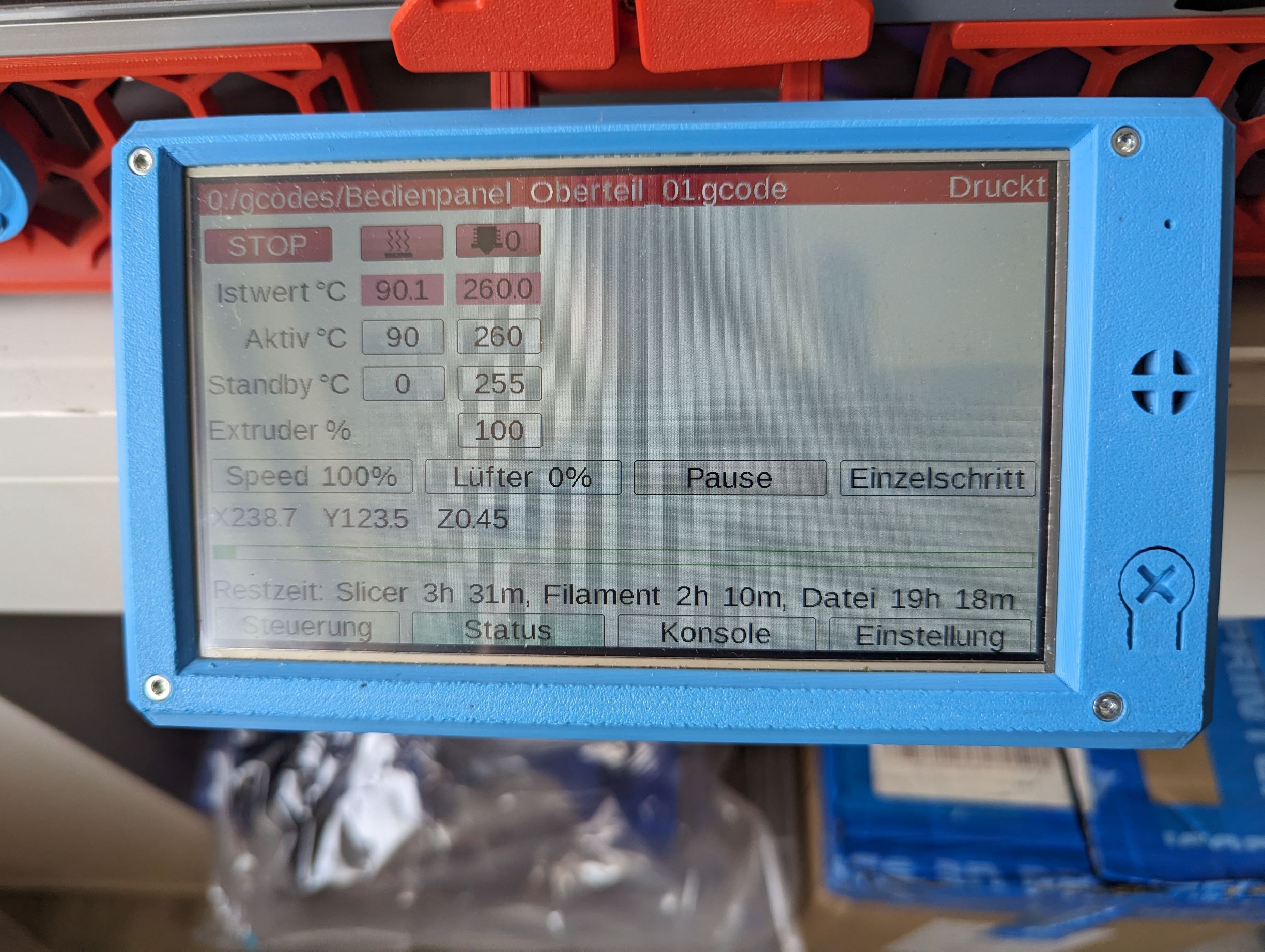

Hello everyone, my Voron now prints perfectly. I still have three small problems:
Although there is space, no preview is displayed on the 5 inch screen, see photo
A preview is only displayed in the web control after an update with F5, which is unfortunate because the status output is then deleted
And now the most annoying thing: After a pause during printing, for example changing to the filament, the gantry remains stationary on the component after printing has finished. Without a pause in pressure, the gantry moves to the top right
Maybe someone can solve one or two problems, thank you for your interest.
Duet3 Mini 5+ Version 3.5.0-rc.1 also the toolhead and the webcontrol have this version
greeting -
@Wobi Sorry, there's no preview display on the status screen at present. The space is currently used when there are multiple tools/beds. For example:
While I think it could possibly be added (@mfs12 ?), it would still be limited to the 200x200 pixel size, due to memory constraints and processing power of the PanelDueFor the pause, check your sys/pause.g file is moving the gantry off the print.
