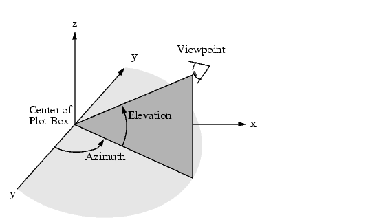

- It's not a requirement. Step 2 in the instructions are so we can perform real world to image relation and find the perspective (elevation, azimuth, distance)
- Mentioned it as
moving the bed towards the camera
because usually for bed slinger printers when timelapses are taken the bed is moved a bit forward for a clearer image of the print. Wanted to generalize a bit but seems I have done the exact opposite. - Yes, exactly. This information will be helpful in finding an offset per setup as we can make a more accurate connection using perspective data we determine/calculate from point 1 above.

Yeah I agree. But having an estimate would be sufficient to support the calibration process.So the test print we ask the users to print and take a timelapse of does actually contain markers so we can come up with a mapping between real-world and pixel coordinates.
Yeah you're right. It was also our initial though to use the calibration image and take images from different coordinates but then later we realised that it would potentially involve a lot of human errors. Hence, the test print(
test_model.stl
). But definitely it would be helpful to take different images of it from different coordinates as opposed to only taking from the timelapse coords.For the time being, yes. The calibration print(
test_model.stl
) and its timelapse would allow us to determine the camera coordinates/perspective to some extent. It's not perfect but it gives an estimation that's within the tolerance levels we accept. -

@yasas One thing that would help is to more fully understand the nature of the study. Its clear that accounting for perspective distortion is part of the puzzle. Just why the position of the extruder matters is a mystery to me, other than perhaps its a marker for relatative position. But relative position of what?
Consider the case of a camera fixed to (say) the printer gantry, and using a cartesian printer with a "drop away" bed (E.g. Ender 5). The printing plane never changes relative to the camera, the extruder moves around in that plane. Some elements being printed will be closer / farther left / right in the camera's field of view (but always in the same plane). At any decent print speed, the extruder has move on from the e.g.layer change position, maybe by quite a lot by the time the image is captured. Does this matter? What perspective information is to be calculated.On the other hand, as the print progresses, already printed portions are moving away from the camera (in the above printer example) and perspective (of the already printed portion) is dominated by z height and independent of the extruder X,Y position.

@stuartofmt AFAIK the position of the extruder only mattered in the case where it was a bed slinger, because its really the Y position of the bed in that case. other than of course the extruder could obscure the print i the images if it was in the way of the camera when a picture was taken.
@T3P3Tony said in Collecting Timelapses - Need your help:
Agree that is likely the case. Given that this is a test model (sorry, I've only just looked) there is only a small number of layers, so Z height variation looks negligible. Also print quality is not really an issue - so perhaps the best approach is to use pause on layer change (where the time lapse software allows) and get the extruder well out of the way
Given this is a masters paper, I was trying to address the more general situation, of an arbitrary model, so that the study as a whole could be more robust.
@stuartofmt sure yes I think the point of the calibration print is simply to use it as a start point for your individual system so the position of the camera relative to the bed can be determined as a system calibration step. then as long as the camera position does not change relative to the bed, the actual time lapses can be of all sorts of models
