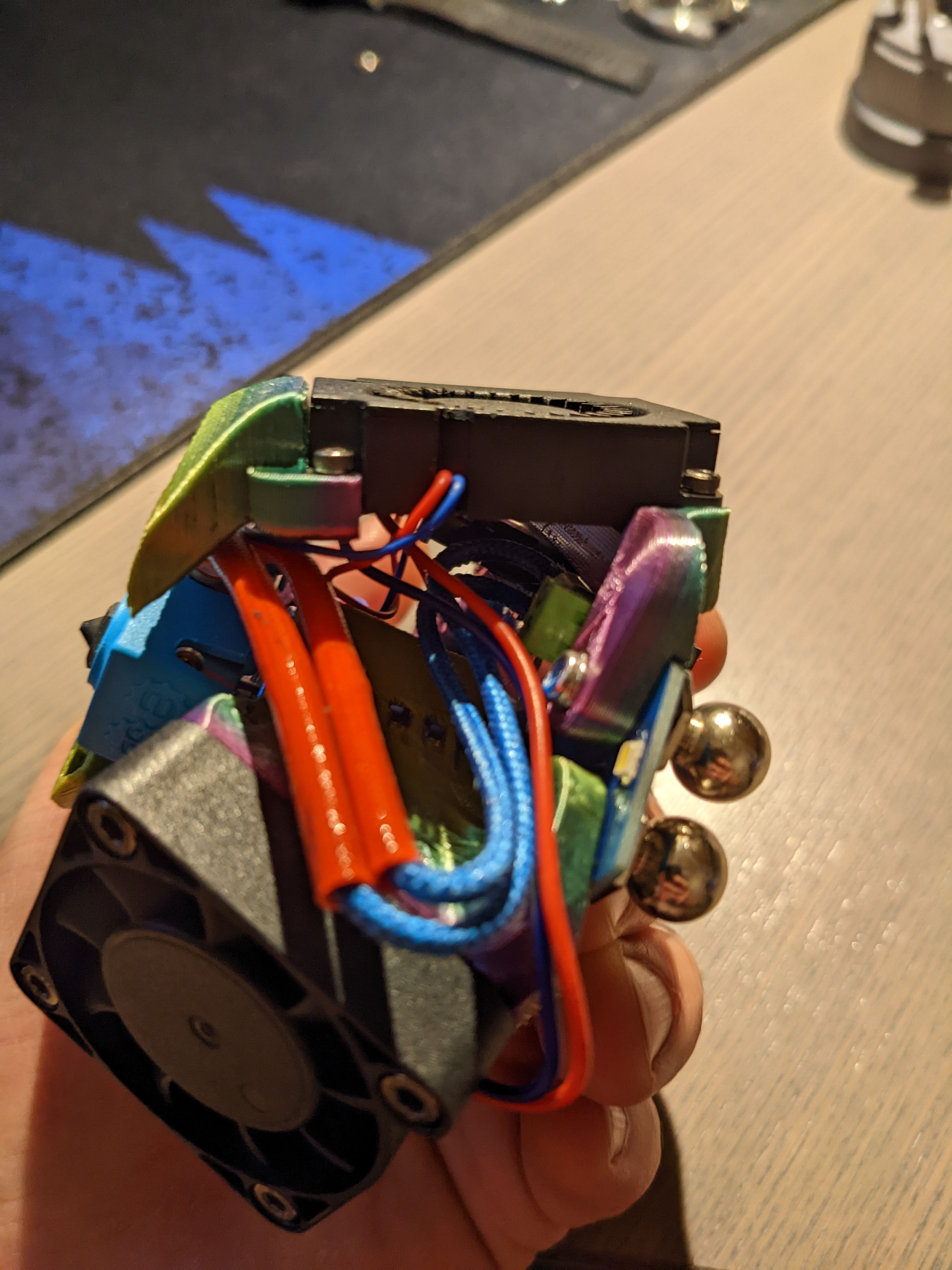

Can you show some photos of your print head and mounting?

Fans are off as is hot end during probe testing, everything is tight, no parts are loose, no play in effector. Is it possible fan mounts could lead to inconsistent readings? Should I pull fan mounts and test with only the hot end?
Thanks!Current one installed
Previous pulled prior to disassembly for replacement.
Can you test it with your printed parts removed? I suspect that they are stiffening the effector and impacting the sensitivity of the strain gauge.

I think that was it! I see so many people using fan mounts similar to this one so i didn't suspect it could cause issues, possibly they are mostly using v2 effectors? Either way ill take it for what it is and get everything going. Thanks for the fast responses and time helping!I sent an M672 S131:131, and rebooted but don't see 2 start up blinks, just one, not sure that is to important.
