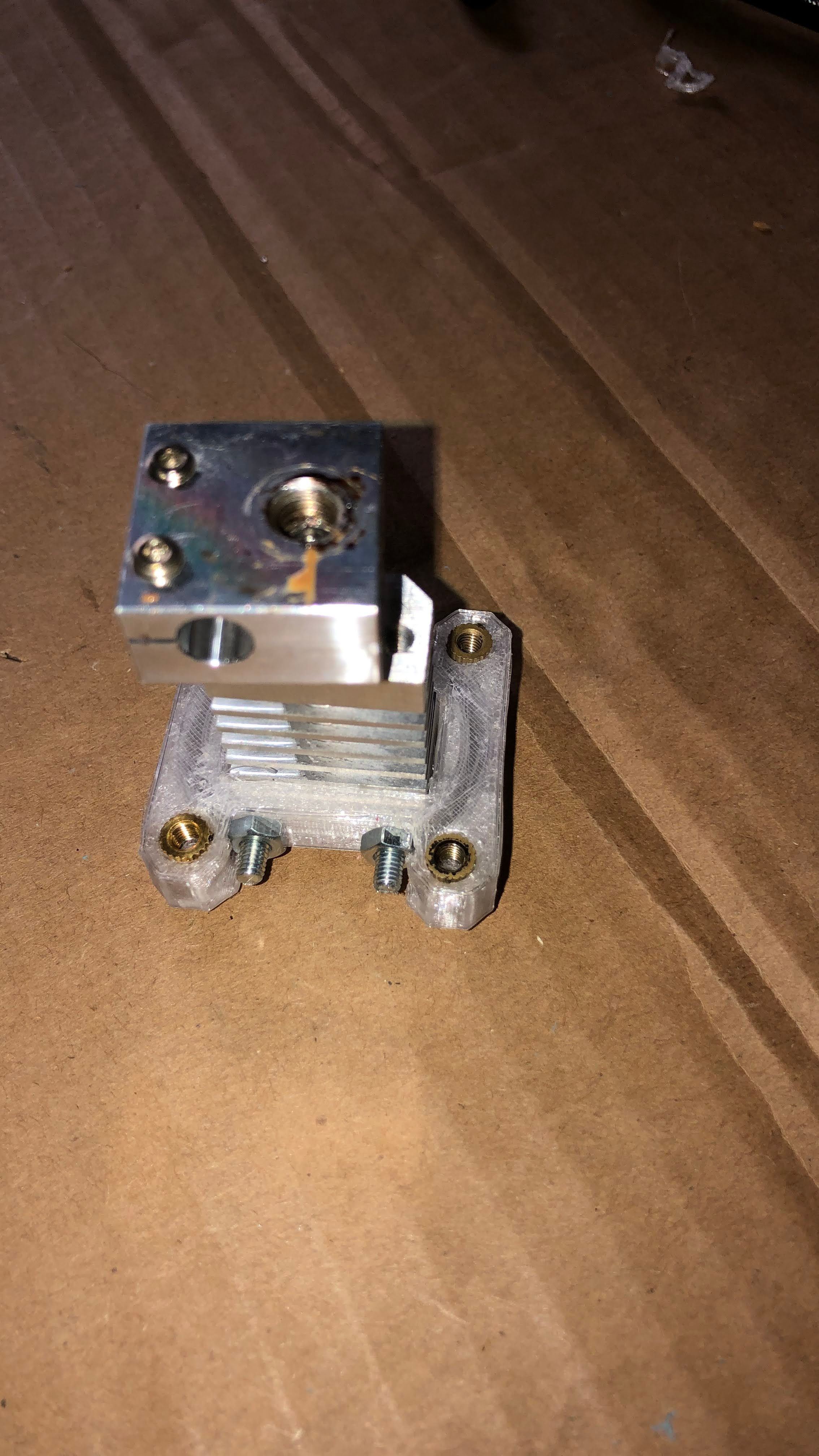

can you post picture from your setup ?
This shows the general layout. I printed the fan duct and bottom mount in PETG and the top mount in PLA (a bit more rigid and further from heat). I also drilled out the top hole a bit and used the screw in collet from the stock ender hotend.
This shows the position of the 3mm inserts for the heatsink fan (2 screws) and the fan duct (2 screws).
And this shows where I used the 2mm nuts as "inserts" (i.e. heated and pushed into the hole.

"By filling in the hollow section you have made the bottom clamp too stiff. The compliance of the bottom part is vital to the correct functioning of the sensor."
So you should ignore my modified bottom mount. I am reprinting .

i have a problem the holes are to big for M3 screws anyone have the same problems ?
Not too big for me - quite snug. I needed to ease them out a little so they would not catch the thread on the screws.
I've reprinted the bottom end per the original thingiverse model - here is what it looks like.Temperature controlled soldering iron (about 300C) works well for slooowly easing in the brass inserts (pre-threaded on a screw). Did not cause the issues I had previously that led down the (garden) path of incorrect remixing. Also - I'm not sure what the original intent was for clamping the hotend, but nuts seemed like a better bet than inserts. A bit fiddly to get onto the screws but otherwise OK.
