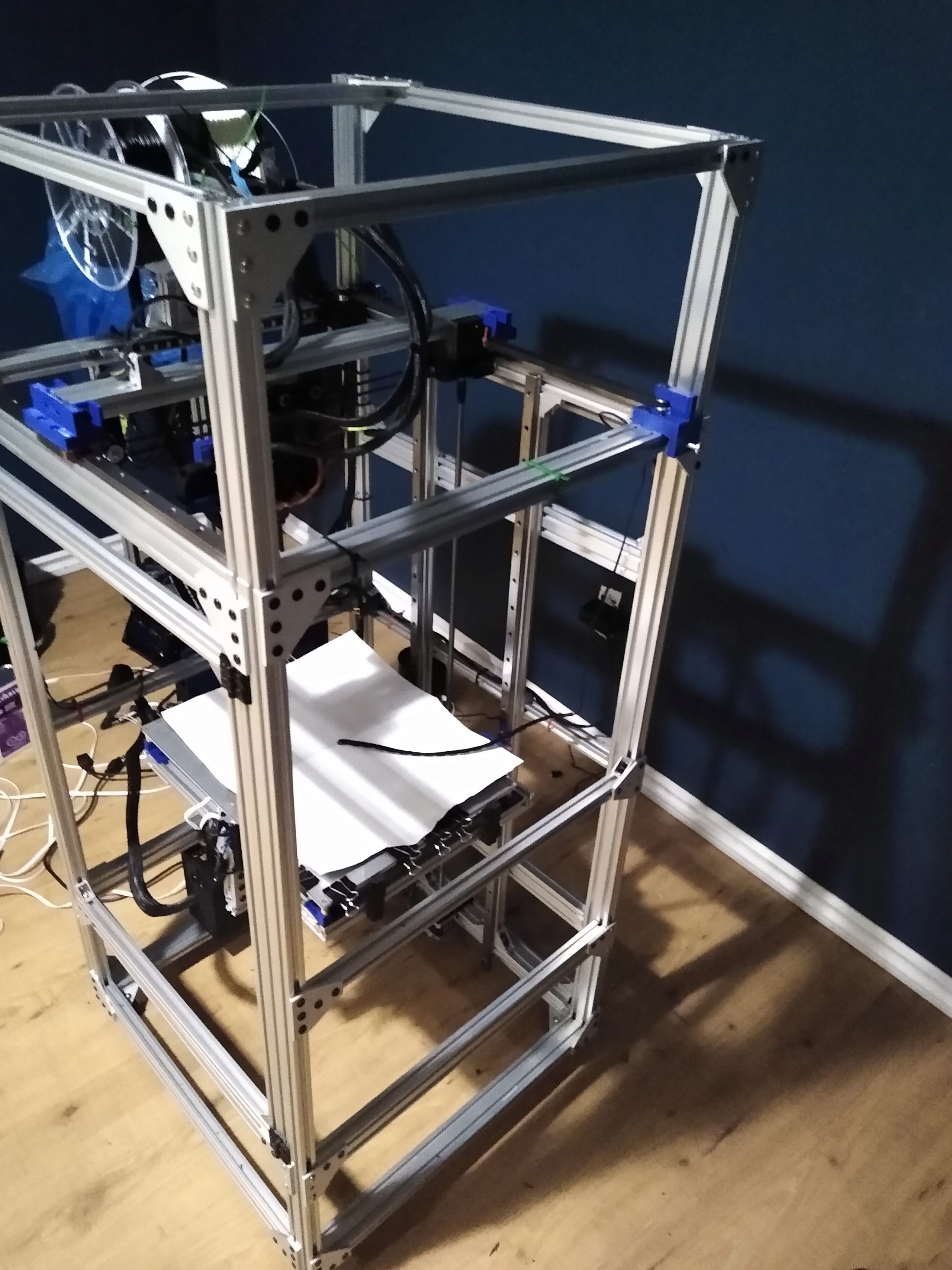

I looked at a few design and when for a more cube design since they seemed more robust than many other design around , main frame is made of 2040 aluminum extrusion bolted together with corner plate with a few reinforcement in the middle of the section the back one as more since it support the vertical rail. it sit on top of 4 big compression spring that act as leg so vibration is not spread back in the frame

The Y gantry went throw a few change throw the project. each change solved an issue , each axis was supposed to be powered by only one .9 degree stepper motor but due to the weight and inertia of the gantry i had to add another one for the X axis , this solved many vibration problem , then came the Y axis , my original idea wasnt great to tension the belt and then found that the cheap linear rail on the Y axis had play in it since i had it in a reverse position , (should have bought the real hiwin) , ended up changing a few thing gain some MM in the Y axis , fixed most vibration now ,
Printable area so far seem to be around 300x350x600mm .i am using a Flexion HT kit for the extruder. print head has 3 blower to cool the print , 1x40mm and 2 x50mm. All stepper motor are .9 degree. The lead screws is m8 x1 one lead only , it take a while to home and get up but give good resolution on the Z plus the 40mm stepper is sufficient even when power is off to keep the Z up

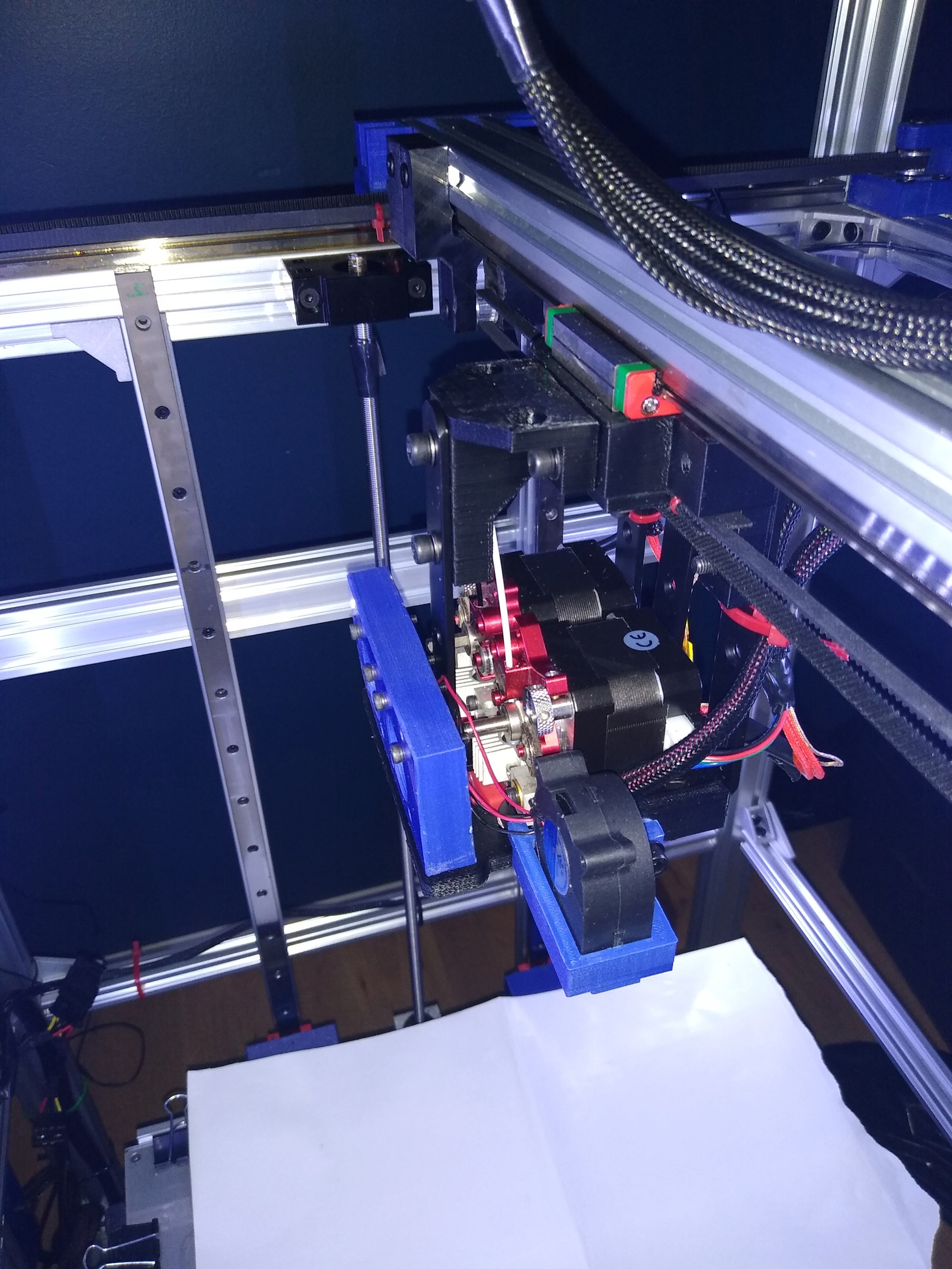

swapped out the cheap chinese rail on the Y axis for a HIWIN HRG15 rail and block , Y axis problem solved,

So what sort of problem were the cheap rails causing?
How did you determine that they were the cause?
Thanks.
@fcwilt there was play between the bloc and rail causing the head to move of probably 1-2 degree in the X axis , causing lower quality on the Y axis , hiwin rail fixed that , had problem with one of the block on the X axis as well , ball would not roll in it i took it a part and couldnt not find the problem so i replaced it by another one seem to be fine now , tolerance on these chinese block and rail are very poor they work OK when there 2 rail on the axis but only one they have too much play they .

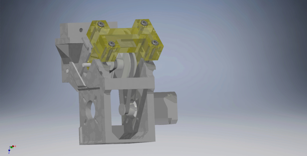

So after a few print i found out that my main problem of poor quality were due to the flexion extruder not having enough pulling force causing extrusion problem .So i ended up ordering a Bondtech BMG-X2 .
still waiting to get it to double check measurement but here what will most likely be. Bl touch probe will be closer abd on a more solid mount. Had to design an adapter to go from 20mm hole spacing to 34mm so i could use the flexion aluminum bar with my mk10 nozzle as well without having to buy a new hotend.
you could also install a second rail on the underside of the x axis. thast would further reduce any play from just one rail
that is actually my Y axis it has an hiwin HGR15 rail with double ball bearing on both side there no play in there

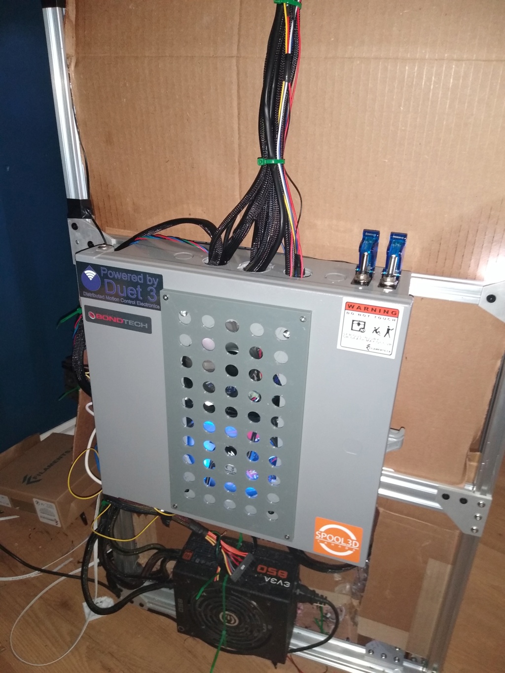

So here another update , ended up swapping the 3d printed elctrical box for an actual box , way bigger , inside it still a mess lol , but at least on the outside it now look cleaner and good , still have ot make my mind on what to use to enclose the printer. still got to tweak 1-2 things , but overall mechanic it working the way i want it or close of it .

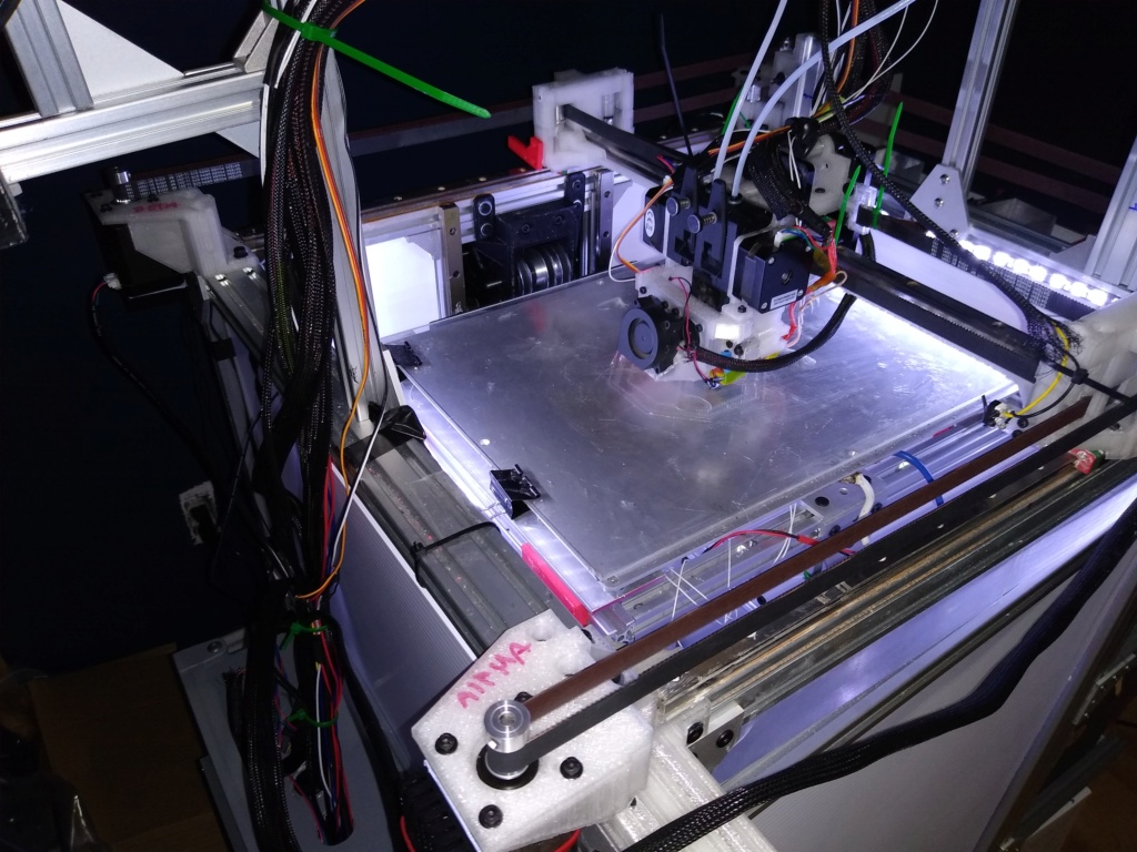

Well here a little update , the Belt system for the Z axis has been working pretty good so far , i swapped my belt tensionner on the X axis as well , the aluminum one would i believe slightly flex when the carriage would change direction putting a finger on then you would feel slight vibration from then so i drawed some and printed them , just need to test to see if it actually changed something , last few print i did were looking decently good compared to before or what my old rostock max v2 could do .
still need a few more tweaking i believe but him not too far to get a perfectly smooth surface without seeing any layer difference while printing a .1mm layer height.
in the future i will get some more aluminum extrusion and had a few shelf on one side so i can put the multiple box of material i have , at the same time it will make the machine a little more heavier and should reduce vibration as well
here a quick picture of the new belt tensionner it does look better ! it print better as well, it seem to have got rid of most of the vibration that i could feel before .

Looks good! I like the electronics enclosure box.
